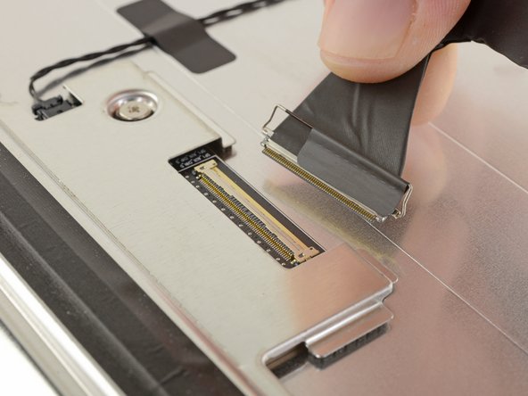

    • Flip up the metal retaining bracket on the display data cable.
    • Disconnect the display data cable.
    • This is a delicate connection that can easily be broken. Be sure to pull the display data cable connector straight out of its socket, toward the top of the iMac.

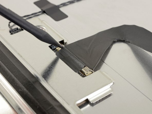

    • Use your fingernail or the pointed tip of a spudger to flip up the retaining flap on the display data connector.
    • Pull the display data cable connector straight out of its socket on the back of the display.

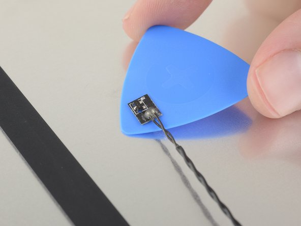

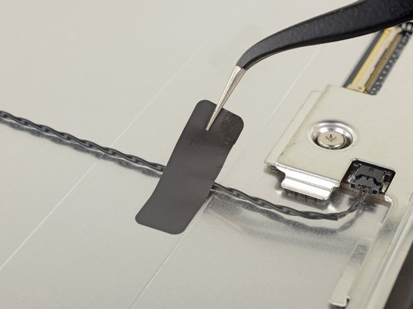

    • If necessary, use an iOpener to heat and soften the adhesive on the two pieces of tape holding the thermal sensor in place.
    • Use tweezers to peel the tape off of the thermal sensor and its cable.
  26. iMac Intel 27" Retina 5K Display 2019 Display Replacement: crwdns2935265:026crwdnd2935265:01crwdnd2935265:02crwdne2935265:0 iMac Intel 27" Retina 5K Display 2019 Display Replacement: crwdns2935265:026crwdnd2935265:02crwdnd2935265:02crwdne2935265:0
    • Slide an opening pick under the thermal sensor to separate it from the display.
    • If the thermal sensor adhesive is stubborn, you may need to apply more heat to soften it.

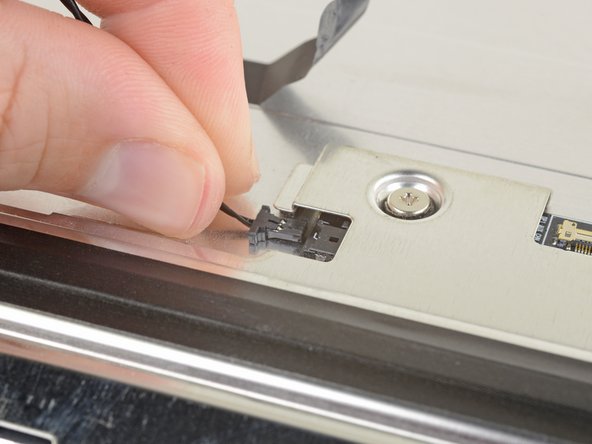

    • Disconnect the thermal sensor from its socket on the back of the display.
    • Remove the thermal sensor and transfer it to your new display assembly.
