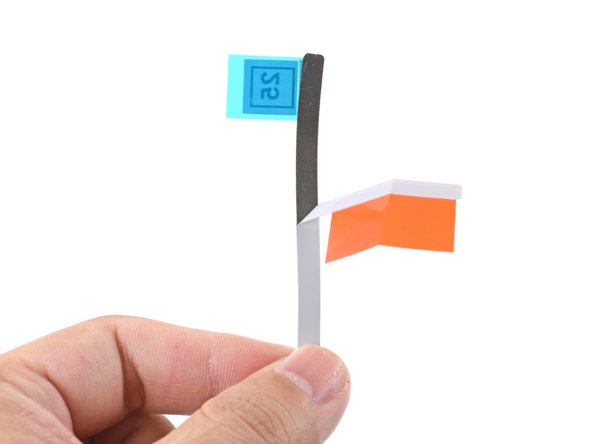

  1. iMac Intel 27" Retina 5K Display 2019 Adhesive Strips Replacement, Determine which adhesives you have: crwdns2935265:01crwdnd2935265:01crwdnd2935265:01crwdne2935265:0
    • Before you begin, make sure you have the right adhesive strips:
    • The 2012-2019 iMac adhesive strips have a microphone cutout and are numbered 16, 21, 22, 23, 25, and 26. They can be used on 27" iMacs from 2012-2019.
    • If your strips are numbered 11-16, follow the 2012-2015 iMac adhesive guide instead.

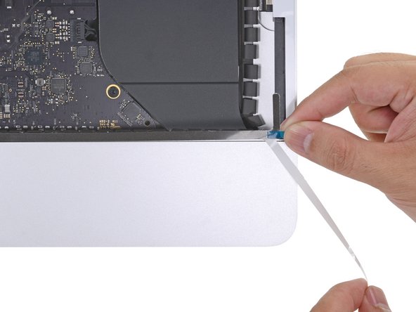

    • Peel off the adhesive strips using tweezers or your fingers. Start at the bottom and peel upward towards the top of the device.
    • After all the old adhesive is removed, carefully clean the surface with 90% (or greater) isopropyl alcohol and a lint-free cloth. Wipe in one direction, not back and forth.
    • Don't skip this step, or your new adhesive strips may not bond properly, and the display may fall out of your iMac.

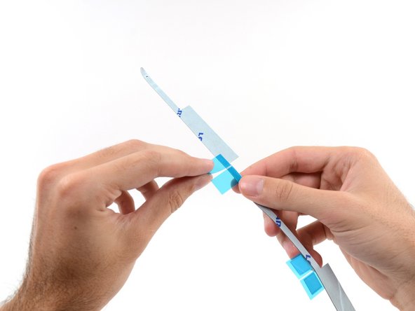

    • Insert the tip of a spudger into the hole at the end of the strip where you just removed one layer of backing. Insert the spudger from the side that still has a layer of white backing on it.
  7. iMac Intel 27" Retina 5K Display 2019 Adhesive Strips Replacement: crwdns2935265:07crwdnd2935265:01crwdnd2935265:03crwdne2935265:0 iMac Intel 27" Retina 5K Display 2019 Adhesive Strips Replacement: crwdns2935265:07crwdnd2935265:02crwdnd2935265:03crwdne2935265:0 iMac Intel 27" Retina 5K Display 2019 Adhesive Strips Replacement: crwdns2935265:07crwdnd2935265:03crwdnd2935265:03crwdne2935265:0
    • With the spudger still poking through the hole in the adhesive strip, push the spudger tip into the corresponding hole in the frame of the iMac.
    • Using the hole and spudger to anchor the position of the adhesive strip, line the strip up against the right edge, gently pull down against the spudger to ensure the strip is taut, and stick it onto the frame.

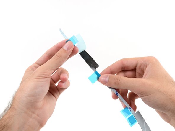

  8. iMac Intel 27" Retina 5K Display 2019 Adhesive Strips Replacement: crwdns2935265:08crwdnd2935265:01crwdnd2935265:03crwdne2935265:0 iMac Intel 27" Retina 5K Display 2019 Adhesive Strips Replacement: crwdns2935265:08crwdnd2935265:02crwdnd2935265:03crwdne2935265:0 iMac Intel 27" Retina 5K Display 2019 Adhesive Strips Replacement: crwdns2935265:08crwdnd2935265:03crwdnd2935265:03crwdne2935265:0
    • Once you're satisfied that the top half of the adhesive strip is neatly aligned, peel longer blue piece of backing out from behind the strip.
    • If the top half isn't aligned properly, you can carefully peel it up and re-stick it before peeling off the lower backing strip. Be sure to use the spudger tip to anchor the top.

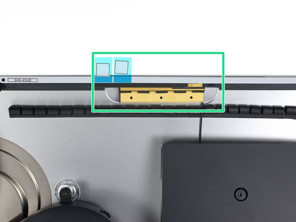

    • These three strips have a hole at each end—always use the smaller hole for alignment for more precise placement.
    • On the iMac Intel 27" Retina 5K Display, the top-right strip's blue tabs will not line up with the top antenna in the same way as the non-5K model. This is perfectly acceptable and won't impact the performance of the strips or antenna.

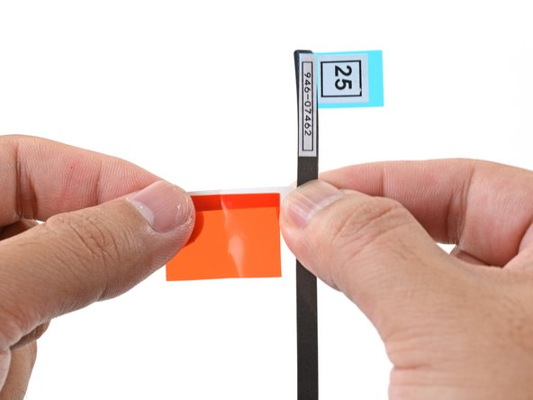

    • Grasp the red pull tab on strip 25 and pull to separate about 2 inches (5 cm) of white backing from the strip.
  13. iMac Intel 27" Retina 5K Display 2019 Adhesive Strips Replacement: crwdns2935265:013crwdnd2935265:01crwdnd2935265:03crwdne2935265:0 iMac Intel 27" Retina 5K Display 2019 Adhesive Strips Replacement: crwdns2935265:013crwdnd2935265:02crwdnd2935265:03crwdne2935265:0 iMac Intel 27" Retina 5K Display 2019 Adhesive Strips Replacement: crwdns2935265:013crwdnd2935265:03crwdnd2935265:03crwdne2935265:0
    • Fold the loose white backing to a right angle and pinch the crease with your fingers.
    • This exposes 2 inches of adhesive while folding the red tab out of the way.

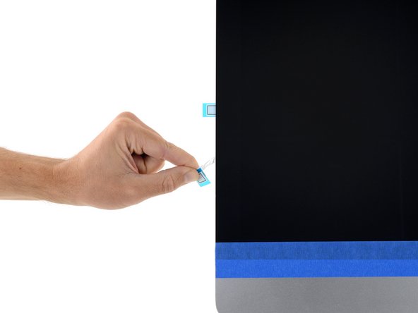

  19. iMac Intel 27" Retina 5K Display 2019 Adhesive Strips Replacement: crwdns2935265:019crwdnd2935265:01crwdnd2935265:02crwdne2935265:0 iMac Intel 27" Retina 5K Display 2019 Adhesive Strips Replacement: crwdns2935265:019crwdnd2935265:02crwdnd2935265:02crwdne2935265:0
    • Use painter's tape or masking tape to temporarily secure the bottom edge of the display to the iMac's enclosure.
    • The tape preserves the display's alignment, and allows you to safely swing the top edge of the display open to access the display cables.

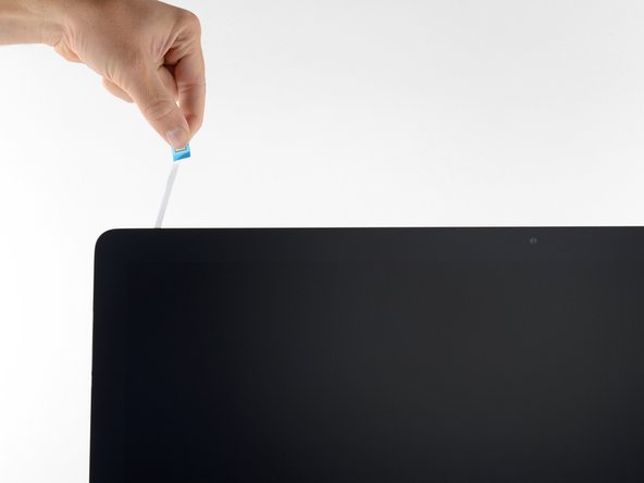

    • Check the glass directly in front of the webcam for dust and other contaminants. If necessary, wipe it down with a microfiber cloth before you seal up the display.
    • Steady the display with one hand as you remove the protective film in the following steps, or rest it lightly against the iMac's enclosure.
  25. iMac Intel 27" Retina 5K Display 2019 Adhesive Strips Replacement: crwdns2935265:025crwdnd2935265:01crwdnd2935265:03crwdne2935265:0 iMac Intel 27" Retina 5K Display 2019 Adhesive Strips Replacement: crwdns2935265:025crwdnd2935265:02crwdnd2935265:03crwdne2935265:0 iMac Intel 27" Retina 5K Display 2019 Adhesive Strips Replacement: crwdns2935265:025crwdnd2935265:03crwdnd2935265:03crwdne2935265:0
    • Remove one side of the protective film from the top left strip by pulling its tab straight up.
  26. iMac Intel 27" Retina 5K Display 2019 Adhesive Strips Replacement: crwdns2935265:026crwdnd2935265:01crwdnd2935265:02crwdne2935265:0 iMac Intel 27" Retina 5K Display 2019 Adhesive Strips Replacement: crwdns2935265:026crwdnd2935265:02crwdnd2935265:02crwdne2935265:0
    • Remove the other side of the protective film from the top left strip.
  27. iMac Intel 27" Retina 5K Display 2019 Adhesive Strips Replacement: crwdns2935265:027crwdnd2935265:01crwdnd2935265:02crwdne2935265:0 iMac Intel 27" Retina 5K Display 2019 Adhesive Strips Replacement: crwdns2935265:027crwdnd2935265:02crwdnd2935265:02crwdne2935265:0
    • Repeat the previous steps to remove the protective films from all the remaining adhesive strips.
  28. iMac Intel 27" Retina 5K Display 2019 Adhesive Strips Replacement: crwdns2935265:028crwdnd2935265:01crwdnd2935265:02crwdne2935265:0 iMac Intel 27" Retina 5K Display 2019 Adhesive Strips Replacement: crwdns2935265:028crwdnd2935265:02crwdnd2935265:02crwdne2935265:0
    • To ensure a strong bond, carefully tip the iMac flat on its back (with the screen facing straight up) and press carefully but firmly around all four edges of the display.
    • Remove the tape securing the display to the rear enclosure.
    • Check the display after 24 hours to make sure that it is not loose on the iMac.
