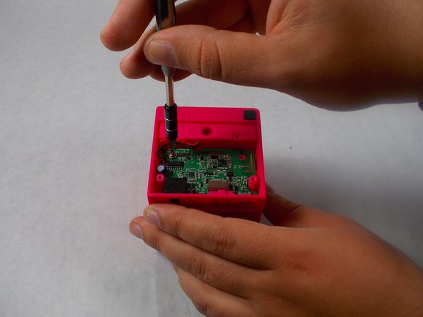

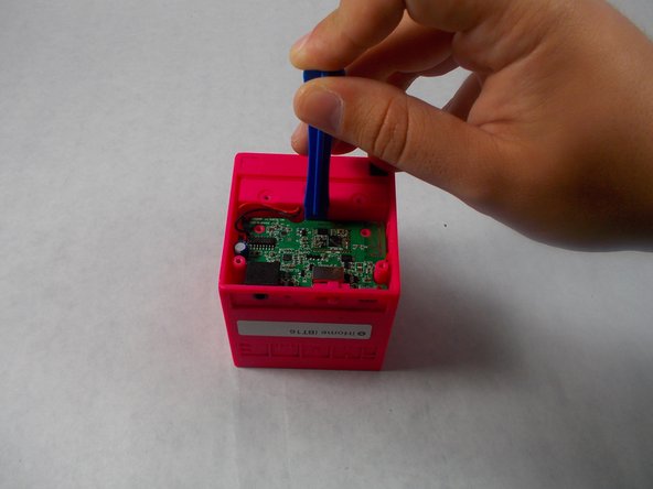

  3. iHome iBT16 Motherboard Replacement, Motherboard: crwdns2935265:03crwdnd2935265:01crwdnd2935265:03crwdne2935265:0 iHome iBT16 Motherboard Replacement, Motherboard: crwdns2935265:03crwdnd2935265:02crwdnd2935265:03crwdne2935265:0 iHome iBT16 Motherboard Replacement, Motherboard: crwdns2935265:03crwdnd2935265:03crwdnd2935265:03crwdne2935265:0
    • Connect the ground strap to earth ground and put it around your wrist.
    • Unscrew the two 10mm silver phillips screws holding the motherboard in place on the inside of the device.
    • Use the plastic opening tool to pry the motherboard out of the device housing.

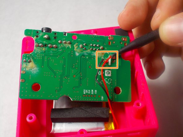

  4. iHome iBT16 Motherboard Replacement: crwdns2935265:04crwdnd2935265:01crwdnd2935265:02crwdne2935265:0 iHome iBT16 Motherboard Replacement: crwdns2935265:04crwdnd2935265:02crwdnd2935265:02crwdne2935265:0
    • If you are unfamiliar with soldering and unsoldering components, see the Soldering Skills Guide.
    • Unsolder the red and black wires connecting the speaker to the motherboard.
    • Flip the motherboard over.
    • Unsolder the red and black wires connecting the battery to the motherboard.
    • When reassembling your device, be sure to connect the speaker and battery with correct polarity.
  5. iHome iBT16 Motherboard Replacement: crwdns2935265:05crwdnd2935265:01crwdnd2935265:01crwdne2935265:0
    • Remove the plastic cover from the power switch actuator on the motherboard.
