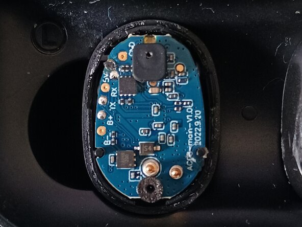

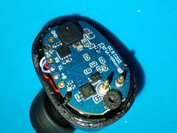

  7. fix rattling sound, Remove the heat stake: crwdns2935265:08crwdnd2935265:01crwdnd2935265:02crwdne2935265:0 fix rattling sound, Remove the heat stake: crwdns2935265:08crwdnd2935265:02crwdnd2935265:02crwdne2935265:0
    • The PCB is being held by 3 pins on of which is heat staked (the marked one).
    • Carefully remove it using flush cutters or scalpel.
    • Be careful not to short circuit anything.

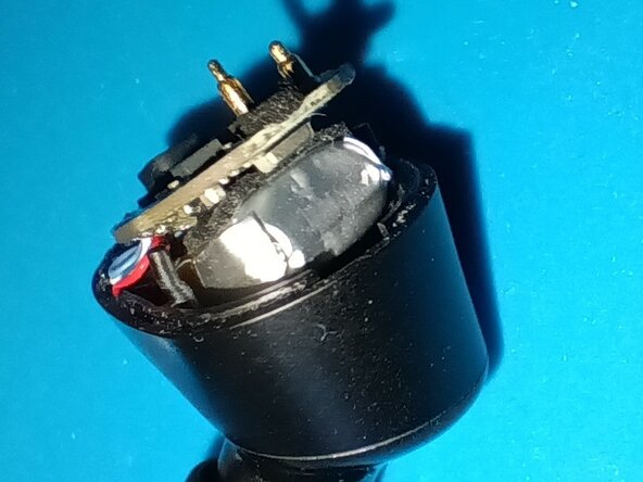

  8. fix rattling sound, Lift the PCB: crwdns2935265:09crwdnd2935265:01crwdnd2935265:02crwdne2935265:0 fix rattling sound, Lift the PCB: crwdns2935265:09crwdnd2935265:02crwdnd2935265:02crwdne2935265:0
    • Carefully lift the PCB.
    • Do not use a metal spudger or similar to avoid a short circuit!

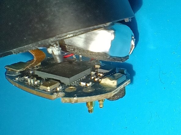

  9. fix rattling sound, Lift the battery up: crwdns2935265:010crwdnd2935265:01crwdnd2935265:02crwdne2935265:0 fix rattling sound, Lift the battery up: crwdns2935265:010crwdnd2935265:02crwdnd2935265:02crwdne2935265:0
    • Separate the battery from the PCB.
  10. fix rattling sound, Apply super glue: crwdns2935265:011crwdnd2935265:01crwdnd2935265:01crwdne2935265:0
    • Apply super glue on top of the marked chips to stick down the battery.
    • Put the PCB back in place for a few seconds to give the adhesive time to pin the battery in the right place.
    • Lift it up again and press the battery softly on to the PCB to maximize the area that the glue can stick to.

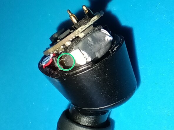

  11. fix rattling sound, Add B7000 (optional): crwdns2935265:012crwdnd2935265:01crwdnd2935265:01crwdne2935265:0
    • The battery often rests again the front plastic pin when assembled.
    • For additional stability and protection of the battery a bit of flexible adhesive like B7000 can be applied in the marked area.
  12. fix rattling sound, Glue down the PCB: crwdns2935265:013crwdnd2935265:01crwdnd2935265:02crwdne2935265:0 fix rattling sound, Glue down the PCB: crwdns2935265:013crwdnd2935265:02crwdnd2935265:02crwdne2935265:0
    • Put a bit of super glue on the pin that was cut of at the beginning of this guide (green marker) to secure the PCB again.
    • Optionally put some on the other 2 pins marked in yellow too.
