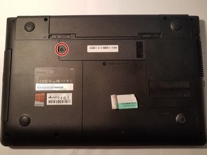

Look for the compartment with the Wifi symbol on it.
Using the Phillips #1 screwdriver remove the M2.5X5 screw, located beside the Wifi Symbol.
Using the plastic spudger, carefully pry the Wifi panel off.
