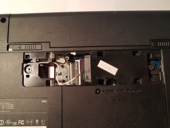

    • Flip over the laptop so you are facing the backside.
  2. Samsung NP350V5C-T02US Wifi card Replacement: crwdns2935265:02crwdnd2935265:01crwdnd2935265:03crwdne2935265:0 Samsung NP350V5C-T02US Wifi card Replacement: crwdns2935265:02crwdnd2935265:02crwdnd2935265:03crwdne2935265:0 Samsung NP350V5C-T02US Wifi card Replacement: crwdns2935265:02crwdnd2935265:03crwdnd2935265:03crwdne2935265:0
    • Look for the compartment with the Wifi symbol on it.
    • Using the Phillips #1 screwdriver remove the M2.5X5 screw, located beside the Wifi Symbol.
    • Using the plastic spudger, carefully pry the Wifi panel off.
  3. Samsung NP350V5C-T02US Wifi card Replacement: crwdns2935265:03crwdnd2935265:01crwdnd2935265:02crwdne2935265:0 Samsung NP350V5C-T02US Wifi card Replacement: crwdns2935265:03crwdnd2935265:02crwdnd2935265:02crwdne2935265:0
    • Gently remove the two wires attached to the the Wifi card by using the plastic spudger to pry from underneath the attachment points.
    • Using the #2 Phillips screwdriver, remove the M2.5X3 mm screw holding in the Wifi card
  4. Samsung NP350V5C-T02US Wifi card Replacement: crwdns2935265:04crwdnd2935265:01crwdnd2935265:02crwdne2935265:0 Samsung NP350V5C-T02US Wifi card Replacement: crwdns2935265:04crwdnd2935265:02crwdnd2935265:02crwdne2935265:0
    • Using you hand, gently pull out the Wifi card.
