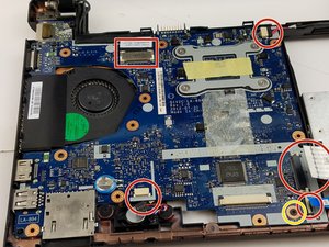

Disconnect the five ribbons by pulling gently on the ribbon.
Unscrew the M2x3 screw.
Disconnect the blue connector from the motherboard.
Disconnect the wider white connector from the motherboard.
