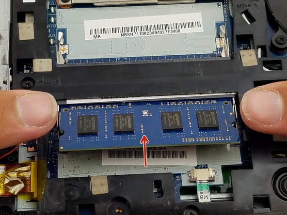

    • Locate the RAM and the metal clips holding the RAM in place.
  3. Acer Chromebook C710-2856 Motherboard Replacement: crwdns2935265:03crwdnd2935265:01crwdnd2935265:02crwdne2935265:0 Acer Chromebook C710-2856 Motherboard Replacement: crwdns2935265:03crwdnd2935265:02crwdnd2935265:02crwdne2935265:0
    • Push the two clips outwards at the same time with your fingers. The RAM will gently pop upwards.
  4. Acer Chromebook C710-2856 Motherboard Replacement: crwdns2935265:04crwdnd2935265:01crwdnd2935265:01crwdne2935265:0
    • Pull the RAM out of the slot.

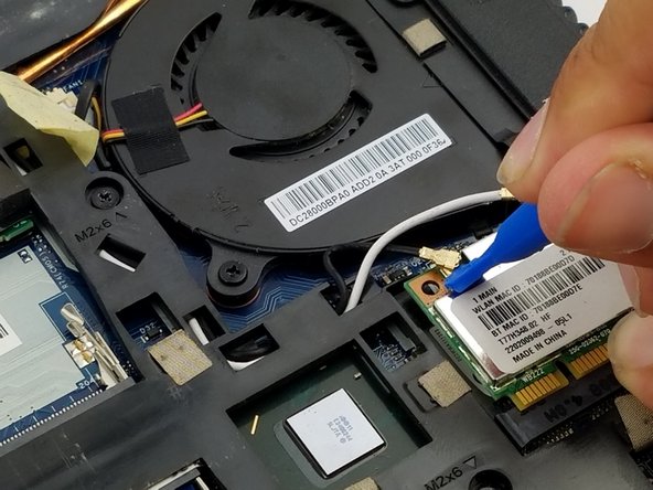

  5. Acer Chromebook C710-2856 Motherboard Replacement, Wi-Fi Card: crwdns2935265:05crwdnd2935265:01crwdnd2935265:03crwdne2935265:0 Acer Chromebook C710-2856 Motherboard Replacement, Wi-Fi Card: crwdns2935265:05crwdnd2935265:02crwdnd2935265:03crwdne2935265:0 Acer Chromebook C710-2856 Motherboard Replacement, Wi-Fi Card: crwdns2935265:05crwdnd2935265:03crwdnd2935265:03crwdne2935265:0

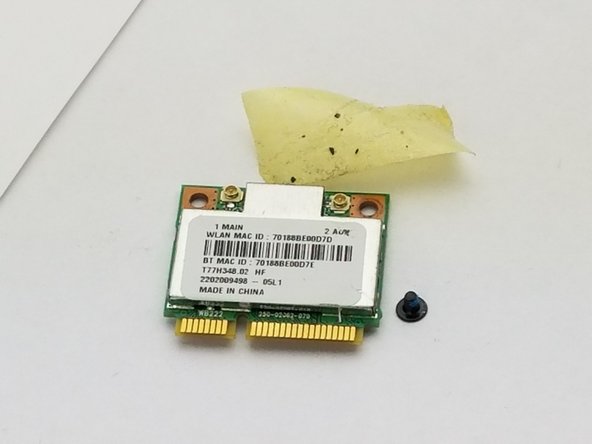

    • Using the Phillips #1 screwdriver, remove the screw from the Wi-Fi card.
    • Carefully remove the piece of tape to allow for more room to remove the Wi-Fi card.
    • Use the blue plastic opening tool to lift and remove the Wi-Fi card from its socket.

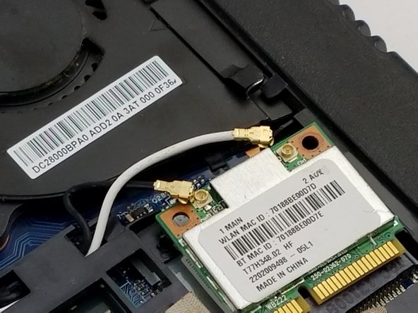

  6. Acer Chromebook C710-2856 Motherboard Replacement: crwdns2935265:06crwdnd2935265:01crwdnd2935265:03crwdne2935265:0 Acer Chromebook C710-2856 Motherboard Replacement: crwdns2935265:06crwdnd2935265:02crwdnd2935265:03crwdne2935265:0 Acer Chromebook C710-2856 Motherboard Replacement: crwdns2935265:06crwdnd2935265:03crwdnd2935265:03crwdne2935265:0
    • Use the blue plastic opening tool and carefully remove the connectors from the Wi-Fi card.
  7. Acer Chromebook C710-2856 Motherboard Replacement: crwdns2935265:07crwdnd2935265:01crwdnd2935265:02crwdne2935265:0 Acer Chromebook C710-2856 Motherboard Replacement: crwdns2935265:07crwdnd2935265:02crwdnd2935265:02crwdne2935265:0
    • Remove the Wi-Fi card.

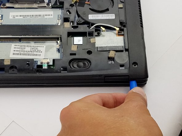

    • Using the blue plastic opening tool, work your way around the perimeter of the laptop and remove the bottom frame.
    • Be careful though, because we will not be pulling it completely apart since we will need to disconnect 2 ribbon cables first (shown in next step).

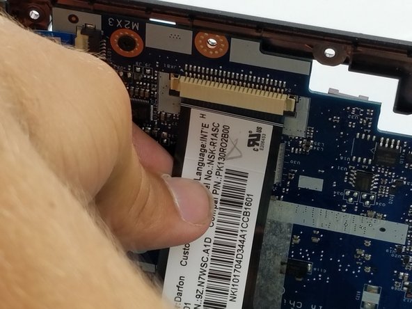

  10. Acer Chromebook C710-2856 Motherboard Replacement: crwdns2935265:010crwdnd2935265:01crwdnd2935265:02crwdne2935265:0 Acer Chromebook C710-2856 Motherboard Replacement: crwdns2935265:010crwdnd2935265:02crwdnd2935265:02crwdne2935265:0
    • Remove the green ribbon on the backside of the laptop by pulling on it lightly as shown.
    • Gently remove the back ribbon that is holding the two parts of the laptop together (found between the two parts that are being pulling apart).
  11. Acer Chromebook C710-2856 Motherboard Replacement: crwdns2935265:011crwdnd2935265:01crwdnd2935265:01crwdne2935265:0
    • Now completely pull apart the motherboard from the underside of the laptop by pulling on the location of the arrows.

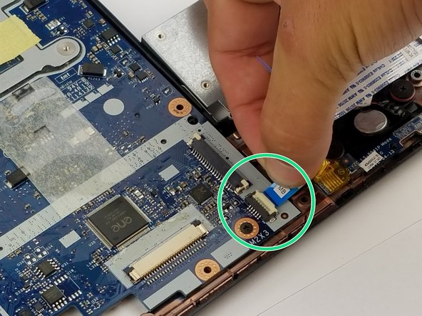

    • Disconnect the five ribbons by pulling gently on the ribbon.
    • Unscrew the M2x3 screw.
    • Disconnect the blue connector from the motherboard.
    • Disconnect the wider white connector from the motherboard.

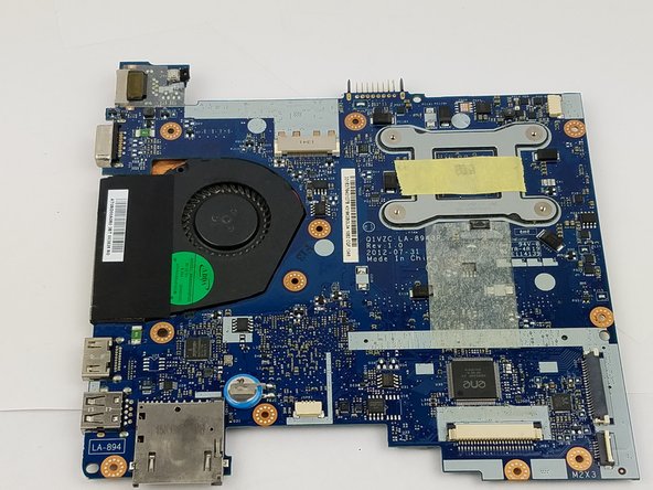

  13. Acer Chromebook C710-2856 Motherboard Replacement: crwdns2935265:013crwdnd2935265:01crwdnd2935265:02crwdne2935265:0 Acer Chromebook C710-2856 Motherboard Replacement: crwdns2935265:013crwdnd2935265:02crwdnd2935265:02crwdne2935265:0
    • Remove the motherboard from the frame.

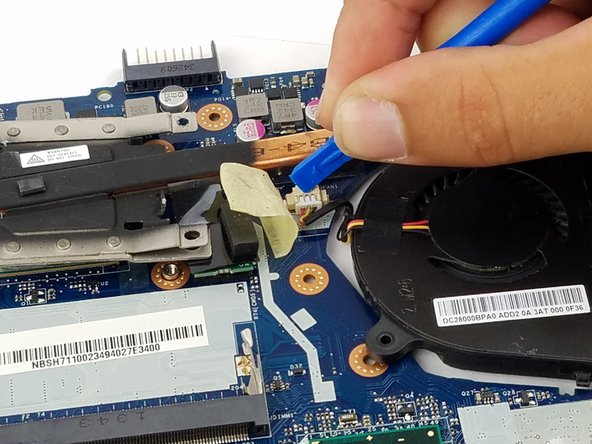

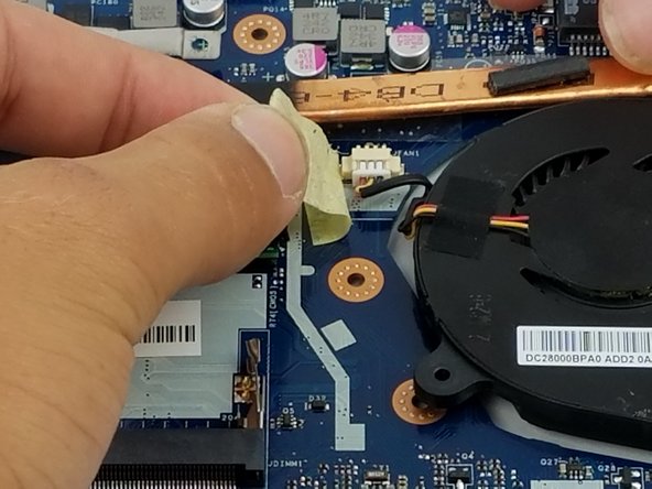

  14. Acer Chromebook C710-2856 Motherboard Replacement: crwdns2935265:014crwdnd2935265:01crwdnd2935265:03crwdne2935265:0 Acer Chromebook C710-2856 Motherboard Replacement: crwdns2935265:014crwdnd2935265:02crwdnd2935265:03crwdne2935265:0 Acer Chromebook C710-2856 Motherboard Replacement: crwdns2935265:014crwdnd2935265:03crwdnd2935265:03crwdne2935265:0

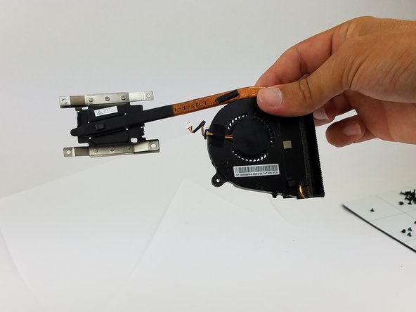

    • Remove the fan by unscrewing two M2x3 screws.
    • Peel the tape off the ribbon connection for easy access.
    • Use the plastic opening tool to disconnect the connector.
  15. Acer Chromebook C710-2856 Motherboard Replacement: crwdns2935265:015crwdnd2935265:01crwdnd2935265:02crwdne2935265:0 Acer Chromebook C710-2856 Motherboard Replacement: crwdns2935265:015crwdnd2935265:02crwdnd2935265:02crwdne2935265:0
    • Remove the fan.
  16. Acer Chromebook C710-2856 Motherboard Replacement: crwdns2935265:016crwdnd2935265:01crwdnd2935265:01crwdne2935265:0
    • The motherboard is now bare of any extras and is ready to be replaced.
