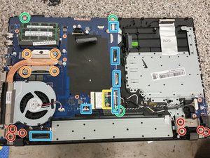

Remove the four heatsink screws surrounding the CPU socket. This is necessary as the heatsink blocks the hinges from being removed.
Remove the 7 Philips screws securing the hinges to the palmrest.
Turn the hinges away from the palmrest. You may need to use a screwdriver to pry, but be careful if you do!
Remove the antenna connectors from the Wi-Fi card.
Remove all of the shown connectors. Remove the motherboard screw hidden by the video cable. You'll have to break out the Philips #0 bit for this, if you haven't already.
Remove the three remaining motherboard screws.
