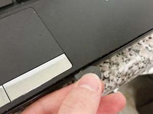

Use a guitar pick to separate the base from the palmrest.
This type of laptop is the kind that the motherboard is attached to the palmrest, rather than the base, and so, the base comes off.
