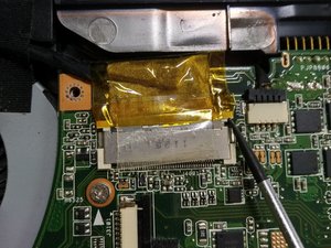

use the tip of a spudger or a tiny flathead screwdriver to push out the LCD cable from connector.
be very very very carefull , if you tear tis cable or damage it , you will have to buy a new one.
first lift the cable metal connector upwards ( push it out) , very gently, then the other side untill you can remove the cable.
