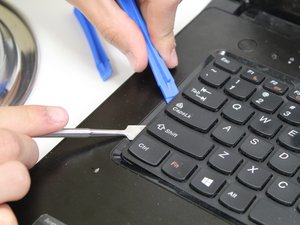

With a plastic opening tool, start on the left of the keyboard and gently pry the keyboard off the laptop.
Be careful removing the keyboard to prevent from tearing the delicate connector.
