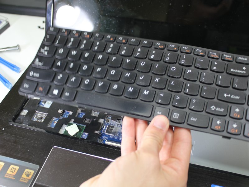

    1. Lenovo G780 Keyboard Replacement, Keyboard: crwdns2935265:03crwdnd2935265:01crwdnd2935265:01crwdne2935265:0
      • Remove the three 9mm keyboard screws with a #0 Phillips screwdriver.
    2. Lenovo G780 Keyboard Replacement: crwdns2935265:04crwdnd2935265:01crwdnd2935265:03crwdne2935265:0 Lenovo G780 Keyboard Replacement: crwdns2935265:04crwdnd2935265:02crwdnd2935265:03crwdne2935265:0 Lenovo G780 Keyboard Replacement: crwdns2935265:04crwdnd2935265:03crwdnd2935265:03crwdne2935265:0
      • With a plastic opening tool, start on the left of the keyboard and gently pry the keyboard off the laptop.
      • Be careful removing the keyboard to prevent from tearing the delicate connector.
    3. Lenovo G780 Keyboard Replacement: crwdns2935265:05crwdnd2935265:01crwdnd2935265:03crwdne2935265:0 Lenovo G780 Keyboard Replacement: crwdns2935265:05crwdnd2935265:02crwdnd2935265:03crwdne2935265:0 Lenovo G780 Keyboard Replacement: crwdns2935265:05crwdnd2935265:03crwdnd2935265:03crwdne2935265:0
      • Slightly lift the keyboard from the laptop.
      • Push the grey lock upward to unlock the ZIF connector.
      • Carefully lift the keyboard connector from its socket.
