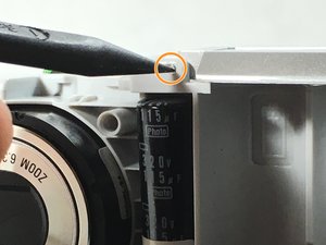

Using the pointed end of the Spudger, push the metal pin out of the hinge as far as it will go (this will typically be halfway).
It can be hard to get the Spudger point to center on the pin, so try choking up on the Spudger.
