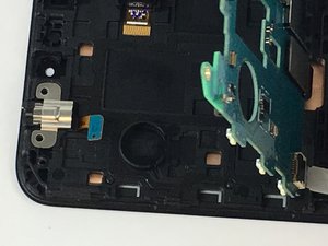

Using tweezers, carefully lift up the motherboard.
Using tweezers, remove the metal jacket holding the headphone jack in place by grabbing the left corner where there is a recess to grab it.
There is a light adhesive holding the metal jacket down. You may have to pull slightly harder to get this off.
