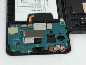

Remove the two Phillips head screws attaching the auxiliary port to the plastic frame using a P000 screwdriver.
