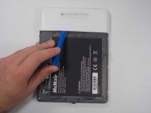

Pry off the second white panel, removing two clips underneath.
Start from the middle, and then work on the sides. The sides may be difficult to remove, so try to focus on one side and work your way around.
