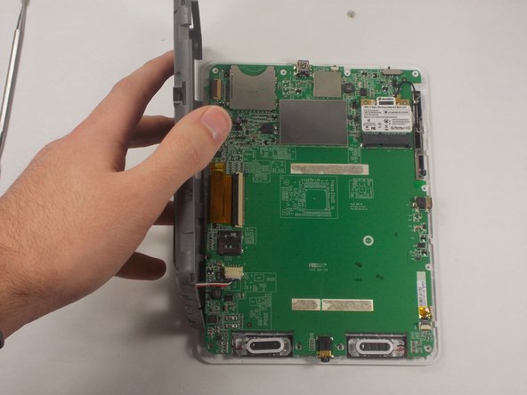

  4. Pandigital Novel PRD07T10WWH7 Battery Replacement: crwdns2935265:04crwdnd2935265:01crwdnd2935265:02crwdne2935265:0 Pandigital Novel PRD07T10WWH7 Battery Replacement: crwdns2935265:04crwdnd2935265:02crwdnd2935265:02crwdne2935265:0
    • Carefully pry the back of the device from the front panel and motherboard. There are a series of clips holding them together that need to be separated.

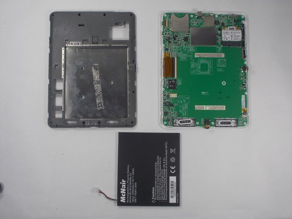

  5. Pandigital Novel PRD07T10WWH7 Battery Replacement: crwdns2935265:05crwdnd2935265:01crwdnd2935265:02crwdne2935265:0 Pandigital Novel PRD07T10WWH7 Battery Replacement: crwdns2935265:05crwdnd2935265:02crwdnd2935265:02crwdne2935265:0
    • Now, lift up the gray piece, unplug the battery connector, and the battery can be removed from the case.
