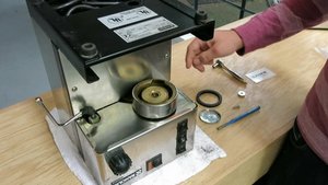

Take the new gasket and install it with the lettering down.
Use a 1/4 inch flat punch to push down the gasket to ensure its nice and flat.
