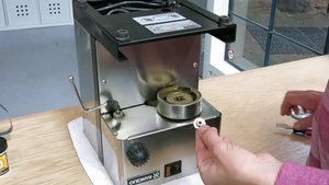

Video Guide Rancilio Silvia Grouphead Screen And Gasket Replacement Grouphead Gasket & Screen Replacement
crwdns2936025:06crwdne2936025:0 —
Remove and soak diffuser in Joe Glo coffee cleaner.
On version 3 you will need to remove and soak the brass disc as well.
