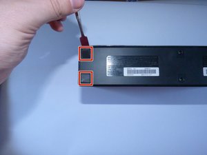

For this guide, the faceplate disassembly is not necessary.
On the bottom of the device, you'll see 4 rubber pieces at the corners. Peel off these rubber pieces.
Unscrew the 4 10mm Philips J1 screws beneath them.
