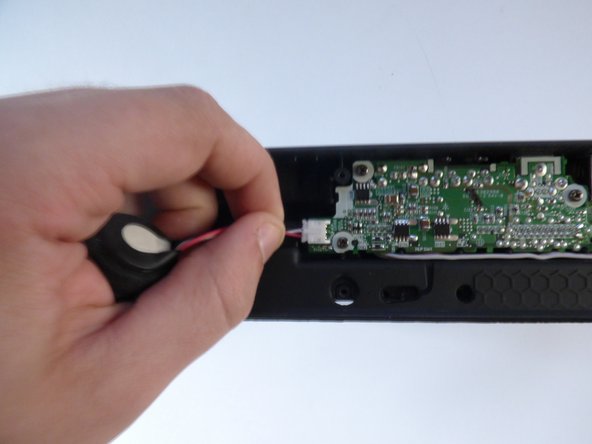

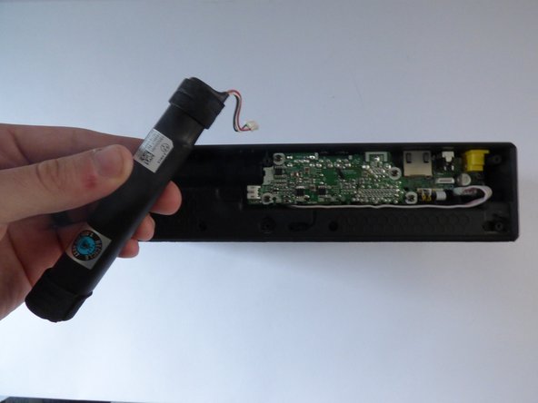

  3. Sony SRS-X7 Power Supply Replacement: crwdns2935265:03crwdnd2935265:01crwdnd2935265:03crwdne2935265:0 Sony SRS-X7 Power Supply Replacement: crwdns2935265:03crwdnd2935265:02crwdnd2935265:03crwdne2935265:0 Sony SRS-X7 Power Supply Replacement: crwdns2935265:03crwdnd2935265:03crwdnd2935265:03crwdne2935265:0
    • Remove the power supply. Be careful as the power supply is still connected to board.
    • Unplug the power supply from the small motherboard as shown.

Hi, do you know where can I find the replacement battery doy te SRS X7. THANKS
Miguel CHUNG SANG - crwdns2934203:0crwdne2934203:0
Hi I replaced my old battery with a new one (LIS2128HNPD). At amazon they say it is a replacement for the SRS-X5 but it perfectly fits in the X7 model too. Unfortunately the battery seems not to be charged (no orange led and the power supply has no load). Can anybody help?
Chris Heyde - crwdns2934203:0crwdne2934203:0
Hi, did you fixed it? I wonder if it’s really the same battery or if you got defect electronics. :-)
yo ! -
I am having the same problem . I wonder if the charging board that is wrapped in with the battery will have to be swapped from original battery to new battery?
