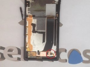

Disconnect the LCD light flex cable by lifting up the black plastic and removing the flex cable from the right side and we are ready to go.
