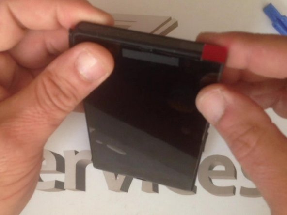

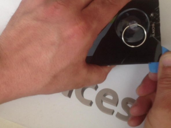

  1. Sony Xperia Z Display Assembly Replacement, Touch Screen Glass Digitizer & LCD Display: crwdns2935265:01crwdnd2935265:01crwdnd2935265:03crwdne2935265:0 Sony Xperia Z Display Assembly Replacement, Touch Screen Glass Digitizer & LCD Display: crwdns2935265:01crwdnd2935265:02crwdnd2935265:03crwdne2935265:0 Sony Xperia Z Display Assembly Replacement, Touch Screen Glass Digitizer & LCD Display: crwdns2935265:01crwdnd2935265:03crwdnd2935265:03crwdne2935265:0
    • Warm the Battery cover before disassemble it.
  2. Sony Xperia Z Display Assembly Replacement: crwdns2935265:02crwdnd2935265:01crwdnd2935265:03crwdne2935265:0 Sony Xperia Z Display Assembly Replacement: crwdns2935265:02crwdnd2935265:02crwdnd2935265:03crwdne2935265:0 Sony Xperia Z Display Assembly Replacement: crwdns2935265:02crwdnd2935265:03crwdnd2935265:03crwdne2935265:0
    • 'Carefully' warm the battery too

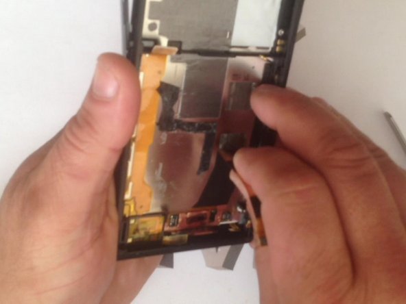

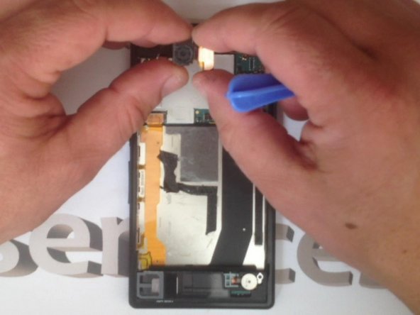

  3. Sony Xperia Z Display Assembly Replacement: crwdns2935265:03crwdnd2935265:01crwdnd2935265:03crwdne2935265:0 Sony Xperia Z Display Assembly Replacement: crwdns2935265:03crwdnd2935265:02crwdnd2935265:03crwdne2935265:0 Sony Xperia Z Display Assembly Replacement: crwdns2935265:03crwdnd2935265:03crwdnd2935265:03crwdne2935265:0

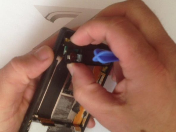

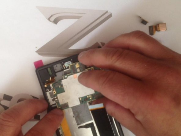

    • Unscrew 4x screws and disconnect 3x flex cables in case to free the mother board.
  4. Sony Xperia Z Display Assembly Replacement: crwdns2935265:04crwdnd2935265:01crwdnd2935265:03crwdne2935265:0 Sony Xperia Z Display Assembly Replacement: crwdns2935265:04crwdnd2935265:02crwdnd2935265:03crwdne2935265:0 Sony Xperia Z Display Assembly Replacement: crwdns2935265:04crwdnd2935265:03crwdnd2935265:03crwdne2935265:0
    • This are: main Camera, front Camera and antenna wire Flex cable.
    • Now we can remove the Motherboard.

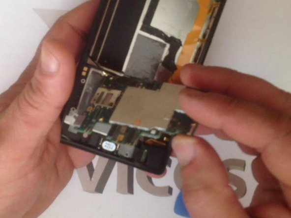

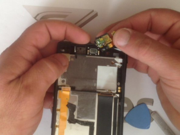

  5. Sony Xperia Z Display Assembly Replacement: crwdns2935265:05crwdnd2935265:01crwdnd2935265:03crwdne2935265:0 Sony Xperia Z Display Assembly Replacement: crwdns2935265:05crwdnd2935265:02crwdnd2935265:03crwdne2935265:0 Sony Xperia Z Display Assembly Replacement: crwdns2935265:05crwdnd2935265:03crwdnd2935265:03crwdne2935265:0
    • The Headphone connector and the Ringer / Cover / Signal Antenna module.

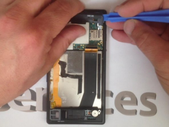

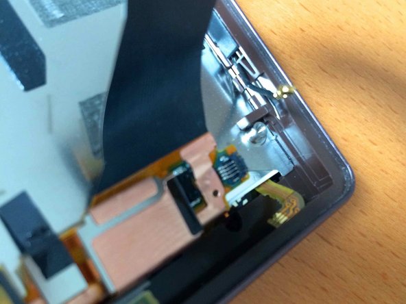

  6. Sony Xperia Z Display Assembly Replacement: crwdns2935265:06crwdnd2935265:01crwdnd2935265:03crwdne2935265:0 Sony Xperia Z Display Assembly Replacement: crwdns2935265:06crwdnd2935265:02crwdnd2935265:03crwdne2935265:0 Sony Xperia Z Display Assembly Replacement: crwdns2935265:06crwdnd2935265:03crwdnd2935265:03crwdne2935265:0
    • Disconnect the LCD light flex cable by lifting up the black plastic and removing the flex cable from the right side and we are ready to go.

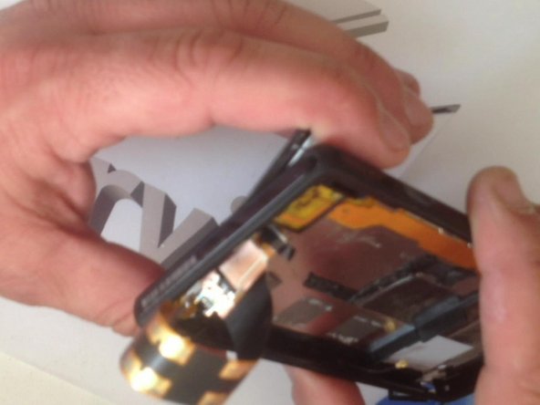

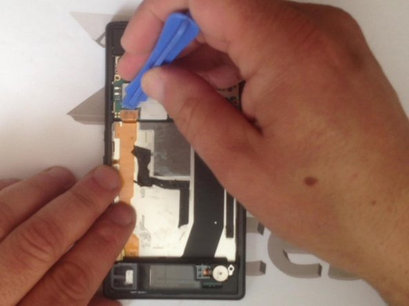

  7. Sony Xperia Z Display Assembly Replacement: crwdns2935265:07crwdnd2935265:01crwdnd2935265:03crwdne2935265:0 Sony Xperia Z Display Assembly Replacement: crwdns2935265:07crwdnd2935265:02crwdnd2935265:03crwdne2935265:0 Sony Xperia Z Display Assembly Replacement: crwdns2935265:07crwdnd2935265:03crwdnd2935265:03crwdne2935265:0
    • Warm the Touch screen before you start to disassemble it.

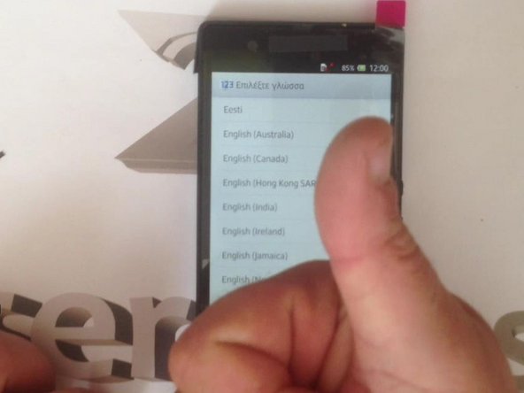

  8. Sony Xperia Z Display Assembly Replacement: crwdns2935265:08crwdnd2935265:01crwdnd2935265:03crwdne2935265:0 Sony Xperia Z Display Assembly Replacement: crwdns2935265:08crwdnd2935265:02crwdnd2935265:03crwdne2935265:0 Sony Xperia Z Display Assembly Replacement: crwdns2935265:08crwdnd2935265:03crwdnd2935265:03crwdne2935265:0

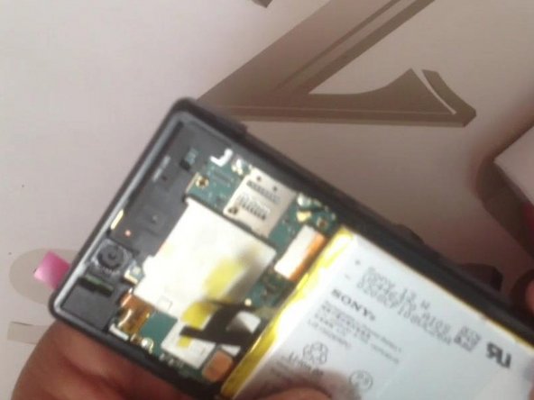

    • Let's assemble the new spare part.
  9. Sony Xperia Z Display Assembly Replacement: crwdns2935265:09crwdnd2935265:01crwdnd2935265:03crwdne2935265:0 Sony Xperia Z Display Assembly Replacement: crwdns2935265:09crwdnd2935265:02crwdnd2935265:03crwdne2935265:0 Sony Xperia Z Display Assembly Replacement: crwdns2935265:09crwdnd2935265:03crwdnd2935265:03crwdne2935265:0
