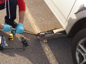

Place the hydraulic jack back under the car and lift it off the cinder blocks or jack stands.
Remove the cinder blocks or jack stands and lower the car back to the ground.
Further tighten the lug nuts using the torque wrench.
Tighten each nut with a torque wrench to a torque of 80ft/lb. See third picture for pattern to ensure proper tire alignment.
