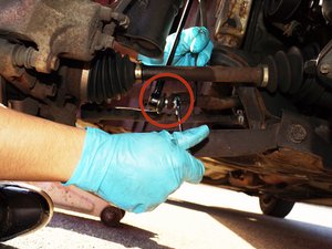

Use the 4mm Allen wrench or 14mm socket wrench to tighten the nut onto the bottom sway bar link.
Repeat for the top sway bar link.
The 4mm Allen wrench is not necessary for this step.
