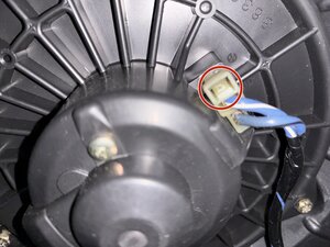

Push on the tab to release the wire harness connector.
Disconnect the wire harness connector.
