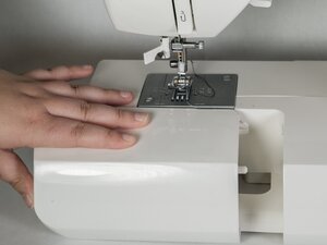

To check the bobbin, remove the front section of the sewing machine by firmly sliding the section to the left.
Open the hinge door towards you to reveal the bobbin.
Check to see if the bobbin is firmly in place. If the bobbin is loose, shift the bobbin to fit firmly in place.
