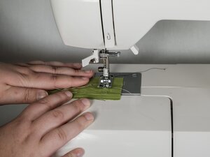

To test the thread tension, take a scrap piece of fabric and sew a short line.
If the thread is getting bunched up leaving an incomplete line, the tension is likely too high. Proper tension will leave a straight, completed line.
Adjust thread tension as needed and retest until it is correct.
