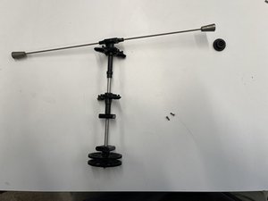

Here, I've disassembled the main propeller.
As some of the parts were pressed together, they were pulled apart with force.
Propeller Inner Frame | Length - 190mm; Width - 9.5mm
Top propeller weights | Length - 310mm; Width 15mm
Main Propeller spinners | Length - 47mm; Width - 10mm
Top propeller wing connector | Length - 53mm; Width - 24mm
Mid way Propeller connector | Length - 53mm; Width - 27mm
Propeller to frame connector bottom | Length - 22mm; Width - 20mm
