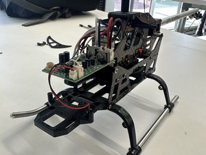

After removing the helicopter's cover, I now had access to the structural parts.
I could then remove the LHS structure of the helicopter.
The dismantling here was pretty good, although there were a couple of parts that needed to be removed carefully so that they wouldn't break in the process.
LHS Inner frame | Length - 130mm; Width 60mm
LHS Outer piece | Length - 120mm; Width - 46mm
Cover holder | Length - 23mm; Width - 22mm
