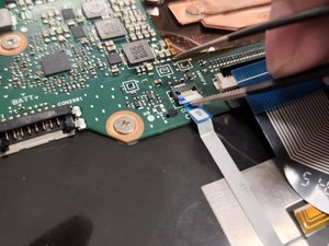

Flip up the ribbon cable tab using a pair of tweezers.
Disconnect the cable by holding the blue tab with your fingers and pulling out towards you.
