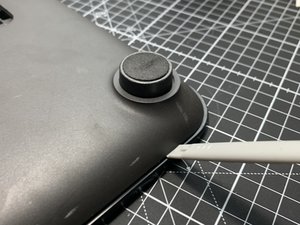

Using a small flathead screwdriver, starting new the corners, pry away the plastic panel from the glass top.
Once the gap is wider use larger pry tools to allow you to pull the bottom section away. You may need to use some force to release the clips.
Note there are no cables of components connected to the bottom plate so do not be concerned about ripping delicate cables.
