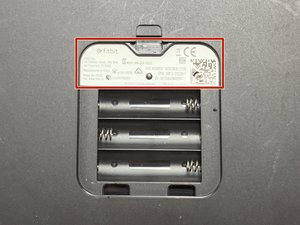

Remove the label in the battery compartment. You can use a small flat headed screwdriver or similar implement to pry the sticker up. (Try to avoid damaging the sticker too much if possible).
Use a Torx T10 screwdriver to remove the two Torx screws and set aside.
