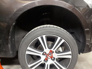

Place the tire flat against the wheel hub and make sure the hub holes line up with the rim holes.
With the 17mm socket, screw the wheelnuts back in. Tighten to 85 N·m.
