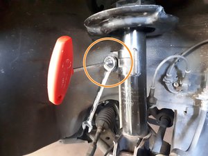

Use the 5mm hex to hold the bolt in place, while loosing the nut with the 14mm wrench.
Pull out the stabilizer bar link from the strut assembly mount.
