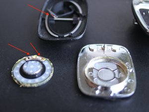

Gently flip each driver area to the side - it will still be connected to the headband with two soldered wires.
De-solder each wire to fully separate the driver area. (Already completed and driver removed in this step.)
