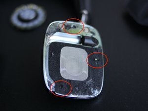

Each side uses three Phillips screws, which are covered in fabric. You can either gently scrape away the fabric in the areas indicated, or insert your driver directly. I did the former but it can bunch up the fabric.
This is the left side.
