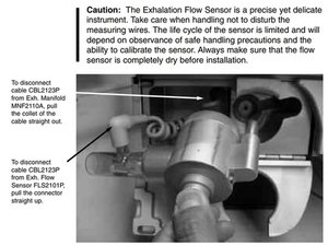

Open the Front Panel Door on the lower left front of the ventilator to expose Exhalation Valve EXH2105A and Flow Sensor FLS2101P.
