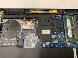

Samsung Series 9 NP900X4B-A02 Motherboard Replacement
crwdns2936025:08crwdne2936025:0 —
Remove the two 2.5 mm Phillips #00 screws connecting the wifi card to the motherboard.
Gently lift up to remove the wifi card from the motherboard.
