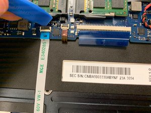

Use the plastic opening tool to flip up the black flap on the ZIF ribbon connector.
Once the flap is open, gently pull out the ribbon from the connector.
