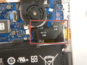

Remove the interconnect ribbon cable labeled “main” and “sub” by prying the pin connections up with a spudger or plastic opening tool.
