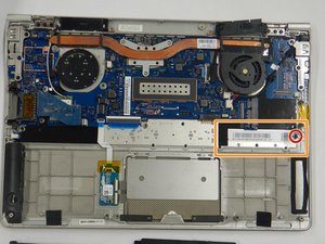

Samsung ATIV Book 9 NP900X3K-S01US SSD Replacement
crwdns2936025:04crwdne2936025:0 —
Remove the single screw holding down the SSD with a Phillips #00 screwdriver.
Remove the SSD from its slot located to the right, just above the battery.
