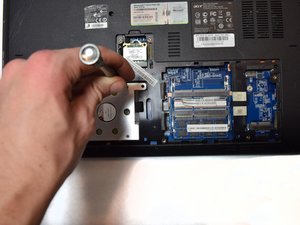

Unscrew all the Phillips #0 6.0mm screws holding the hard drive tray to the laptop.
Remove the hard drive tray.
