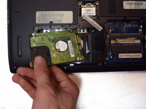

    • Begin by unscrewing the four Phillips #0 7.5mm screws holding the bottom panel.
    • Then lift the panel off the laptop by the tab on its top.
  2. Acer Aspire 7741Z-4643 Hard Drive Replacement: crwdns2935265:02crwdnd2935265:01crwdnd2935265:03crwdne2935265:0 Acer Aspire 7741Z-4643 Hard Drive Replacement: crwdns2935265:02crwdnd2935265:02crwdnd2935265:03crwdne2935265:0 Acer Aspire 7741Z-4643 Hard Drive Replacement: crwdns2935265:02crwdnd2935265:03crwdnd2935265:03crwdne2935265:0
    • Unscrew all the Phillips #0 6.0mm screws holding the hard drive tray to the laptop.
    • Remove the hard drive tray.
  3. Acer Aspire 7741Z-4643 Hard Drive Replacement: crwdns2935265:03crwdnd2935265:01crwdnd2935265:02crwdne2935265:0 Acer Aspire 7741Z-4643 Hard Drive Replacement: crwdns2935265:03crwdnd2935265:02crwdnd2935265:02crwdne2935265:0
    • Use the handle embedded into the hard drive to remove it from the laptop.
