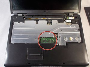

Dislodge the RAM from its slot.
Push the retaining clips outward with your fingers.
