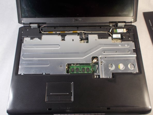

      • Use the Plastic Opening Tools to pry off the tab located on the right side of the top face plate.
    2. Dell Vostro 1700 RAM Replacement: crwdns2935265:02crwdnd2935265:01crwdnd2935265:01crwdne2935265:0
      • Lift the plate off the laptop from right to left.
      • Pull the plate out and remove it.
    3. Dell Vostro 1700 RAM Replacement: crwdns2935265:03crwdnd2935265:01crwdnd2935265:02crwdne2935265:0 Dell Vostro 1700 RAM Replacement: crwdns2935265:03crwdnd2935265:02crwdnd2935265:02crwdne2935265:0
      • Remove the four 3mm Phillips #0 screws.
    4. Dell Vostro 1700 RAM Replacement: crwdns2935265:04crwdnd2935265:01crwdnd2935265:02crwdne2935265:0 Dell Vostro 1700 RAM Replacement: crwdns2935265:04crwdnd2935265:02crwdnd2935265:02crwdne2935265:0
      • Grasp the laptop with both hands as shown.
      • Push the keyboard upwards with your thumbs to disconnect it.
    5. Dell Vostro 1700 RAM Replacement: crwdns2935265:05crwdnd2935265:01crwdnd2935265:02crwdne2935265:0 Dell Vostro 1700 RAM Replacement: crwdns2935265:05crwdnd2935265:02crwdnd2935265:02crwdne2935265:0
      • Lift the keyboard from the laptop and remove it.
      • Ensure the connector is fully disconnected before lifting the keyboard out.
    1. Dell Vostro 1700 RAM Replacement, RAM: crwdns2935265:06crwdnd2935265:01crwdnd2935265:03crwdne2935265:0 Dell Vostro 1700 RAM Replacement, RAM: crwdns2935265:06crwdnd2935265:02crwdnd2935265:03crwdne2935265:0 Dell Vostro 1700 RAM Replacement, RAM: crwdns2935265:06crwdnd2935265:03crwdnd2935265:03crwdne2935265:0
      • Dislodge the RAM from its slot.
      • Push the retaining clips outward with your fingers.
    2. Dell Vostro 1700 RAM Replacement: crwdns2935265:07crwdnd2935265:01crwdnd2935265:03crwdne2935265:0 Dell Vostro 1700 RAM Replacement: crwdns2935265:07crwdnd2935265:02crwdnd2935265:03crwdne2935265:0 Dell Vostro 1700 RAM Replacement: crwdns2935265:07crwdnd2935265:03crwdnd2935265:03crwdne2935265:0
      • Pull the RAM chip up and out.
    3. Dell Vostro 1700 RAM Replacement: crwdns2935265:08crwdnd2935265:01crwdnd2935265:03crwdne2935265:0 Dell Vostro 1700 RAM Replacement: crwdns2935265:08crwdnd2935265:02crwdnd2935265:03crwdne2935265:0 Dell Vostro 1700 RAM Replacement: crwdns2935265:08crwdnd2935265:03crwdnd2935265:03crwdne2935265:0

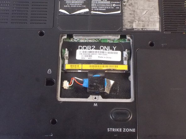

      • Flip the laptop so under side is facing upwards.
      • Remove the 4.5mm Phillips #1 screw from the RAM cover.
      • Lift off the cover.
    4. Dell Vostro 1700 RAM Replacement: crwdns2935265:09crwdnd2935265:01crwdnd2935265:02crwdne2935265:0 Dell Vostro 1700 RAM Replacement: crwdns2935265:09crwdnd2935265:02crwdnd2935265:02crwdne2935265:0
      • Dislodge the RAM from its slot by pushing outwards on the retaining clips.
    5. Dell Vostro 1700 RAM Replacement: crwdns2935265:010crwdnd2935265:01crwdnd2935265:03crwdne2935265:0 Dell Vostro 1700 RAM Replacement: crwdns2935265:010crwdnd2935265:02crwdnd2935265:03crwdne2935265:0 Dell Vostro 1700 RAM Replacement: crwdns2935265:010crwdnd2935265:03crwdnd2935265:03crwdne2935265:0
      • Lift the RAM chip up and out of the slot.
