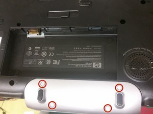

Remove the four screw covers, and then each of the M3x8 screws under them. Beware, these are different from the others.
The hinge cover then slides back and off.
