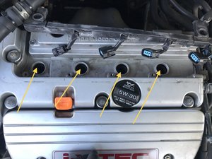

Locate the spark plug at the bottom of the bore.
Use a ratchet, extension, and 5/8 socket to remove the plug by turning counterclockwise until it's free.
You can use a spark plug socket for an easier removal.
