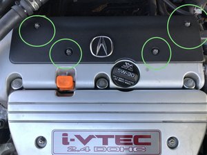

Remove the cover where the Spark Plugs are located
Use a 10 mm hex driver or socket to remove the four screws that hold the spark plug cover in place
Follow the Green circles
